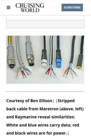

Thanks for the replies. I don’t have any of the Simnet adaptors or m-f converters - but I do have several cut off ends of NMEA drop cables. Don’t especially fancy spending £60+ on the Navico bits to see if the pilot has full functionality from NMEA so I’ll cut off the Simnet female plug on the pilot wiring harness and test it directly attached to an N2K drop cables. Don’t think there is much to lose from doing this as I doubt I’ll ever want to use the Simnet wiring.
