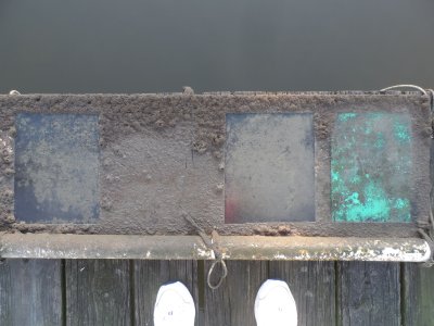

I would expect something more like this. (6 months in the Chesapeake Bay--the testing continued to 3 years). The unpainted areas are a mess.The good looking paints are by Total Boat and Pettit (there were some other good paints on other panels). We did test some slick paints, and they failed miserably. But we did not test Slick One. These photos are before wiping off; the good panels came clean.
