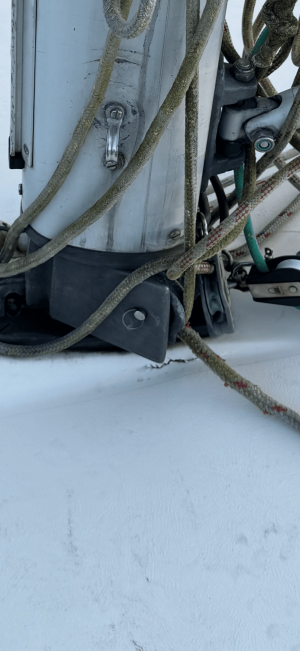

Looking at buying a Sigma 33 which looks really nice overall. But i saw a crack at the base of the mast that i am curious about.
Is this something that is a major red flag?
There are no visible cracks inside or any moisture underneath the mast.

It can be. But not enough info really. Photo would help. I can only assume you mean the crack is in the deck at the foot of the mast, not in the mast section itself. There may be a Sigma "expert" around on here that can tell you of any history of habitual cracking there and why. But a photo would certainly help. Lots of 33's were raced hard. High rig tensions, Potential deck compression and cracking?
Sorry, I thought the image was added to the post.
I looked quickly over the compression post. No signs of water but have not checked top top of it yet.

I would say that it is a crack in the gelcoat with a void underneath rather than a crack caused by compression simply enlarging it will tell you if it is or if it's extensive. Agree with the seller to open it up on the basis of if it is a simple break in the gelcoat with a void beneath it then you will buy the boat, if it's something more then no sale or renegotiation.
Is this boat from the sort of era where there was often a ply pad in the deck plinth part of the mast step? mine was (not a Sigma 33) and that had gone soft enough from water ingress (through a badly sealed electrical fitting) that it had started to compress. It's not that hard to dig it all out and build a block of epoxy-glass instead, then stick a bit of flowcoat over the top, but it's all work. Try a ruler over the deck plinth and see if it's dished.
If the standing rig is old enough that you would swap it anyway, sorting a mast step issue while it's down at least doesn't add much cost or delay, if you can make the time to work on it while the rigging is being made up. If you had to take the mast down just for this, that could be a bit offputting.
I think it might be a crack in the gelcoat as well, due to the size, location, and direction of the crack. I think it would be more alarming if the cracks were protruding outwards away from the mast step. Maybe the mast was tensioned harder on the opposite side.
But this is just speculation on my part.🤷🏽‍♂️
You will want specialist advice on that one Aredz, either from a someone who knows Sigmas well or a good surveyor. From the look of it I would suspect it would need a mast down repair as whatever stands between the post and the mast foot is being compressed, as greeny has hinted.
I agree. I was thinking of asking the seller to open up the gelcoat where the crack is, to inspect a little deeper and get some professionals to check the rig.

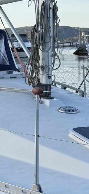

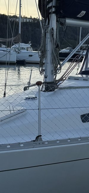

The boat is number 80 in a series of 410 made. I have read that the earliest variants had a slightly softer core than the later ones. When and where in the series this changed, I am not sure of. Looking from the sides, I don’t see any immediate depression, but checking with a ruler was a good idea! Thanks.
I also added two more images of the fastening brackets on the sides. There is some small leakage coming from the steel fasteners. My first thought was that it came from the crack, but I’m not 100% sure of this. (Dont see the tumbnail of the last the images might be large in size)

At a guess, that water staining could be problems with the sealing of the mast shoe bolts and it might indicate time to check the conditions of the shoe and chainplate bolts too.
None of this is an automatic "no" but it's definitely putting the boat in the "needs immediate attention" category.
