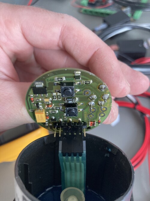

I want to replace the original Sidepower joystick with a Carling rocker switch because the joy stick is ugly and massive.
I’ve wired up an elaborate circuit with relays that makes it time out after 10 minutes and introduces a delay before switching port / starboard.
However, I’m now wondering if the port / starboard delay circuit was a waste of time because the switching delay is built into the thruster control unit itself (rather than being built into the joystick as I assumed).
Anyone know?
To answer my own question the left / right delay is done in the main control unit not the remote.
The remote just has a pretty dumb circuit to do the auto switch off.
