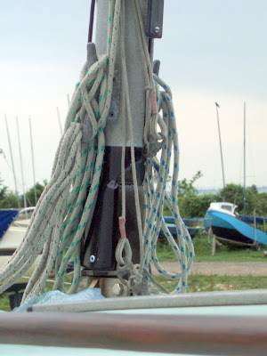

Did the same on my old boat - best picture I have is this - the black section at the bottom is a plug that fitted inside the original mast after the damaged section was trimmed...
We also removed all fittings and re riveted (when I say "we" I mean the rigger!) but you get the idea. I took the opportunity to renew the standing rigging some was happy the whole rig was sound.
