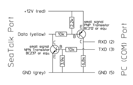

My next project needs to send data to the SeaTalk (1) bus. Being a perfectionist I'm torn between different approaches:
[1] Copy the schematic diagram of a Raymarine instrument:
[2] Use a very simplified circuit from Thomas Knauf:
[3] Try to devise a circuit of intermediate complexity. I could have a stab at it, but not my area of expertise.
Bearing in mind that this is on a live SeaTalk bus that is relied on, what would you choose?

The Raymarine circuit is apparently pulsing TR1a on a +ve going edge to pull the data line up quicker via 390ohms.
The Knauf circuit relies on the 10k resistor to do that, which will be slower, for the same bus capacitance.
The Knauf circuit inverts the data, FWIW. And has less controlled data thresholds.
I expect the Knauf circuit works, while the Raymarine one might meet a specification.
With either of these, the bus can be locked by the talker.
Which can be a nuisance, I have had an instrument bus hang locking the depth readout at something like 3.8m, which was believable until we noticed it was not changing.
There are two differences that concern me.
1. Edge speed.
The "official" version has components that will enhance (speed) the transmitted edges. That will make for better performance over a long bus. Make it more immune to noise. But it will also generate a little more EMC.
2. Conducted noise and spike withstand.
The "official" version has quite a lot of protection. LC filtering (maybe even common mode chokes). Diode clamps and a transient suppressor.
The "Knauf" version has nothing.
In a small boat installation, I doubt edge speed is an issue. But I would be very unhappy to have no protection against noise or spikes.
I would (will when I have time) use the "official" version. It's only a few cheap components.
But if you go for your option 3, make sure you think about noise and spikes.

Both.
If you use the simple circuit and the input transistor gets damaged such that it goes short circuit C to E.
Then you won't damage your other devices, but they won't be able to transfer data on a shorted bus either.

C76, L3 and L11 will reduce the interference the transciever puts on the bus, which may help with radio reception.
Or not.
... In a small boat installation, I doubt edge speed is an issue. But I would be very unhappy to have no protection against noise or spikes. I would (will when I have time) use the "official" version. It's only a few cheap components. But if you go for your option 3, make sure you think about noise and spikes.
From experience of decoding waveforms it's a good idea to keep edge speed up within reason. My longest SeaTalk cable is about 20m, so there will be some HF loss.
Unfortunately, while I understand the issues you raise, I don't have enough experience in circuit design to figure out a circuit. I can do digital, but once you get into transmission lines, even digits become analogue! However, it did occur to me that there may be a suitable line-driver IC that could be used to reduce the component count.

I assume you're familiar with these. While there is a render of the PCB layout in the PDF documentation, no circuit diagram seems to be published - although perhaps the author would share advice on the email also published therein?
Edit: Ah, there's a circuit diagram in another of his projects. Seems he's just using the Knauf version, with a MAX232.

Using this circuit just on a breadboard so far, though can't remember the exact resistor values, something like that. Nmea from a nasa fluxgate compass goes in on the left, 5v ttl out into an arduino serial RX pin on the right.
To our learned friends, would a zener diode between the nmea input and ground help protect against any spikes on the input?
