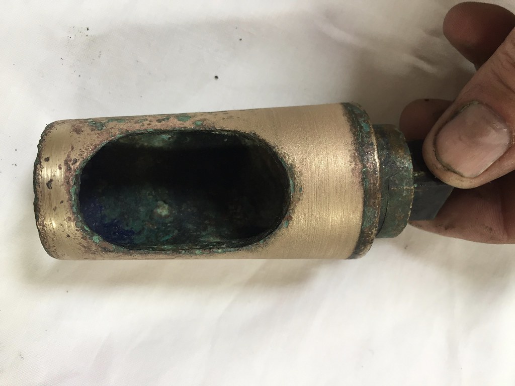

Yes I will lap them before re-fitting.Any ideas about the copper appearance at the top and bottom?They still look as thick
as I would have expected when new?Thanks

That looks in excellent condition. The pinky colour is just surface discolouration and nothing to worry about.

Below is the before and after lapping pictures from one of my cones. I do not what causes the copper but it easily laps out. Maybe it is something to do with zinc depletion but on the surface only as opposed to throughout the structure. Mine are over 40 years old. The lapping stopped a back flow into the galley sink when healed heavily. Before lapping the closed seacock passed when the yacht was pressed. I expect mine to outlast the yacht and me!

40 year old Blakes would be bronze, so dezincification is impossible. Even with non-zinc copper alloys it is quite common for the copper to show on the surface. There is a photo of an 80 year old bronze keel bolt on the website that shows it.

As a by the way, I just noticed on the picture, that the boss which the handle locates onto is cracked. I'll need to keep an eye on that.

If that breaks off you may need a tapered wooden bung and a hammer rather quickly.
I would hold the cone upside down and pour a little meths into it and see if it seeps through the crack.
Not sure it's a crack, looks like a wear step against the keeper plate.
I'm not sure that the keep-plate comes into contact with the round boss. I don't think it does on mine. And it doesn't seem to in this one:
