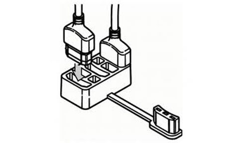

10 Jun 2025 #1 Malish Well-Known Member Joined 9 Nov 2004 Messages 3,943 Location Rochester, UK, boat in SYH Visit site Hi Old tech I know but I'm looking to expand a Seatalk1 network. Does anybody know if this connector block has any active electronic controls inside it or is it just a dumb connector between a series of Seatalk plugs?
10 Jun 2025 #2 Slipstream 34 Well-Known Member Joined 15 Feb 2006 Messages 682 Location Clyde Visit site Just a dumb connection.
10 Jun 2025 #3 1 [164147] ... Joined 31 Aug 2016 Messages 635 Visit site You can cut the plug ends off and just use a Wago connector rather than try and find an overpriced Seatalk socket.

10 Jun 2025 #4 Malish Well-Known Member Joined 9 Nov 2004 Messages 3,943 Location Rochester, UK, boat in SYH Visit site Hi, lovely that's what I hope was the case; and yes, Dr Spock, once confirmed that was my plan Many thanks both Last edited: 10 Jun 2025
