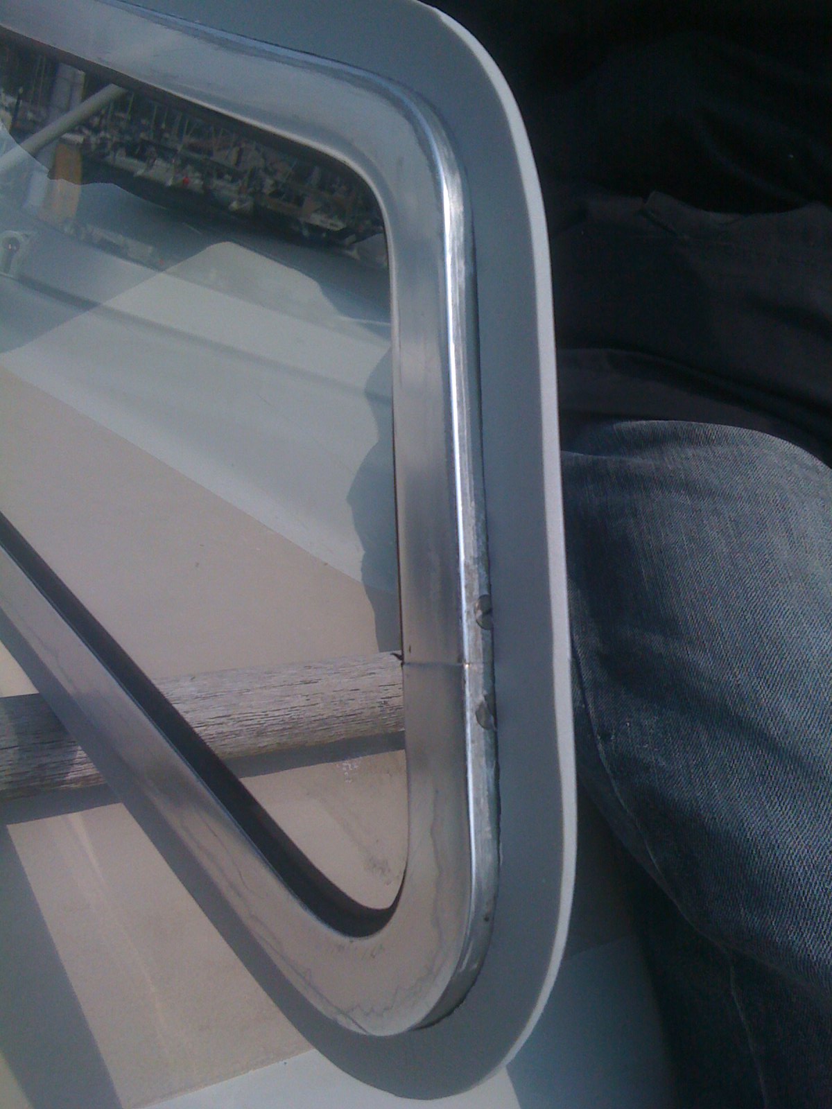

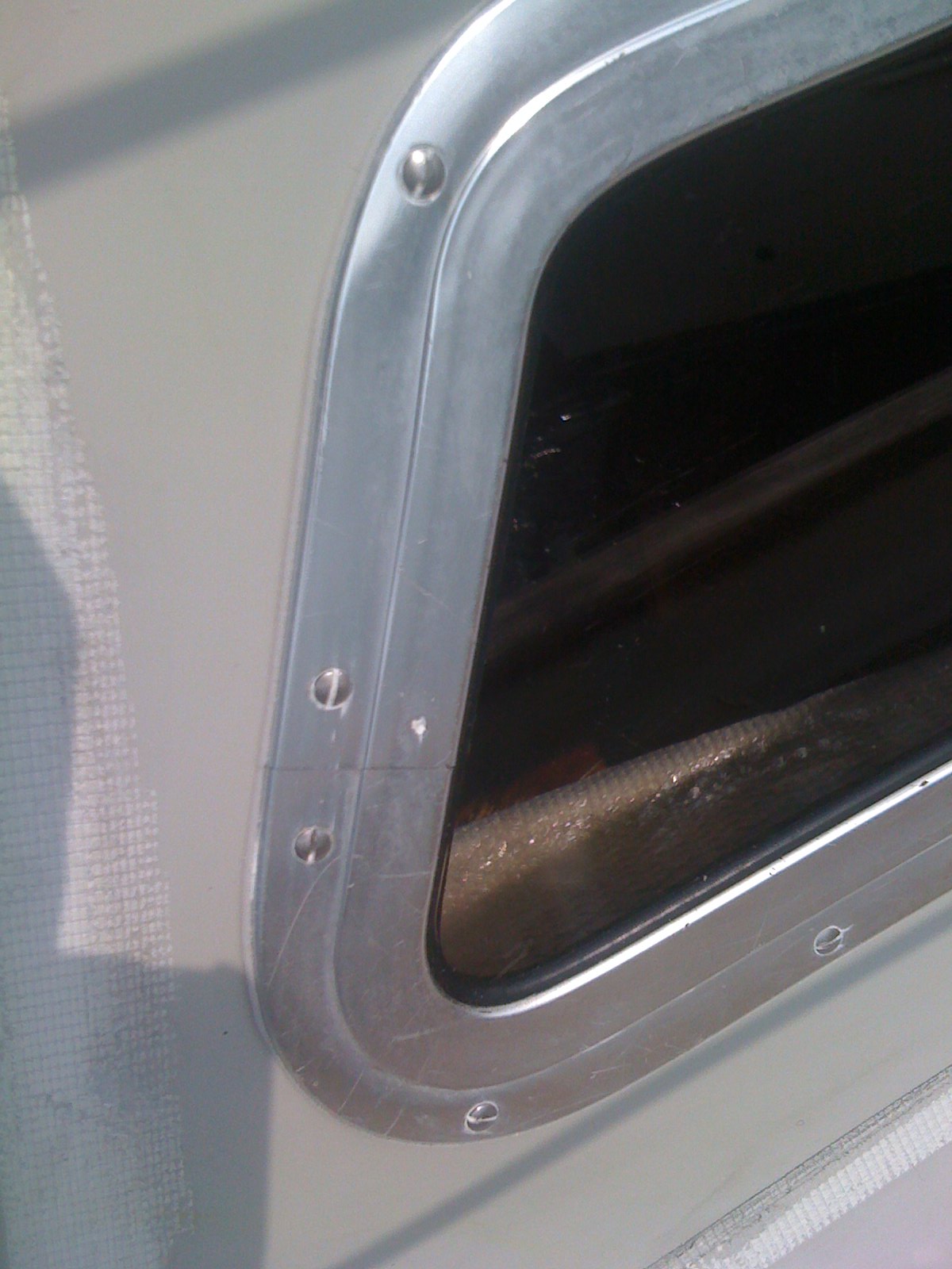

The Scapa Foam mentioned above, post No 4 is what I used. Do not use a sealant and certainly not an adhesive selant. I used the 3mm thick tape on the frames, some of which had to bend around a slight curve in the coachroof, about 7mm offset from the flat, over the frame length. Screw the frame down until you get a good bulge of foam on the corners, on the tightest corners I estimated that the frame was about 0.5 mm away from the coach roof. On the flats I squashed the tape about 2mm. It's over 5 years now and not a drop of water has entered the boat despite the wet West Coast of Scotland and some very heavy weather experiences. Simply put, it is the correct stuff for the job and if you have to remove the window again, no issues as the tape is a resilient seal i.e. it wants to reform to it's original shape. UV wise I have seen no deterioration where it has extruded.

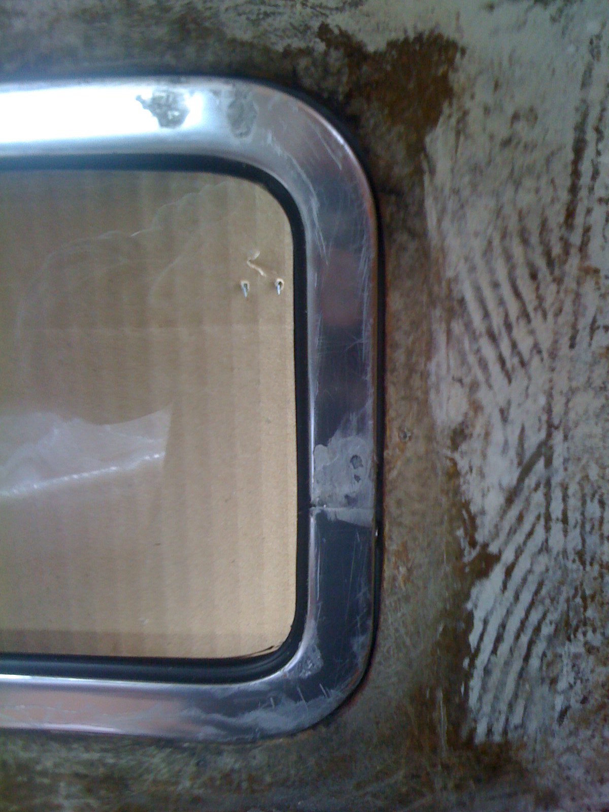

Regarding your persistent leaks. I had this, despite death by sealant, turned out the frames had corroded through on the underside. The channel that the window sat in, U channel, clamped the frame between the a large O ring on the outside and sticky tape on the inside. The O ring was trash and water had been sitting in the U channel and had corroded a hole in the bottom of the frame. Hence, all the sealing of the frame in the world was not going to stop this. The refurbishment resulted in the glass being bonded in the U frame with Sikaflex which filled the frame completely i.e. the O ring and tape that originally held the glass in place was done away with. Hence, check the frames, as water may be leaking internally and not from the flange face of the frame / hull.
Frame and Foam Tape
Extruded Foam Tape After Fitting Window
Corrosion Holes In Frame Sealed With Sikaflex (Similar Holes Were On The Underside)

This is exactly the same as I did for my windows and also on the West Coast. Been in for 10 years with no leaks. Tape came from Hadlow Marine who also refurbished the windows. They were held in originally with sikaflex type sealant and were a pig to get out plus pulling chunks of gel coat off!
