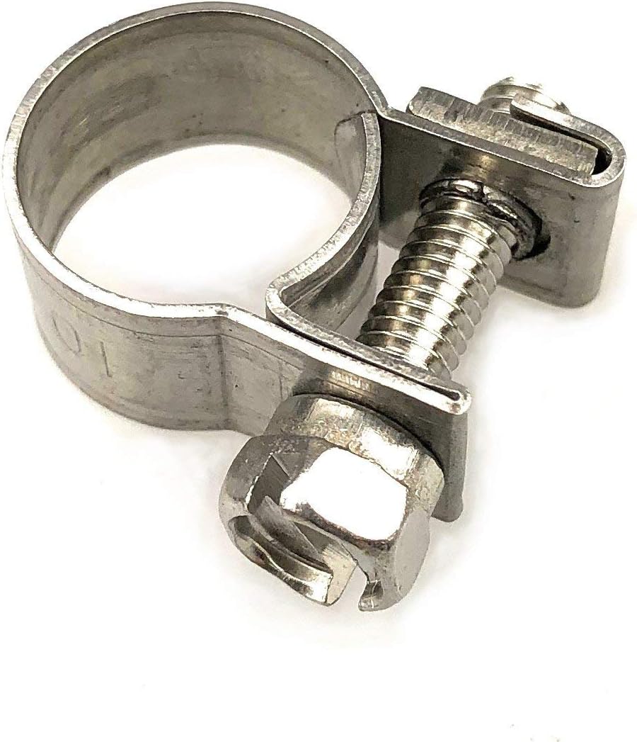

I prefer fuel hose clips like these, without reinforced saddles, which tend to flatten the hose at that point.
You have to buy the correct size.
https://www.amazon.co.uk/Stainless-Jubilee-Petrol-Clamps-Silver/dp/B07MWDJGY3
These are better provided you get the specific size and use on new pipe 6mm Fuel Hose Spring Clip Constant Tension Mikalor Clamp
