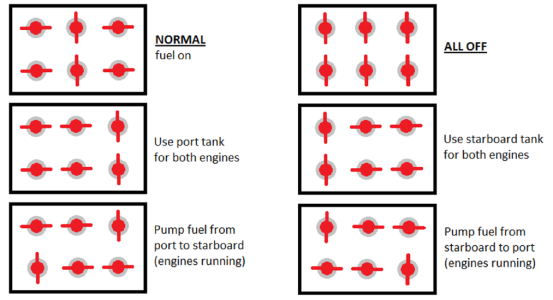

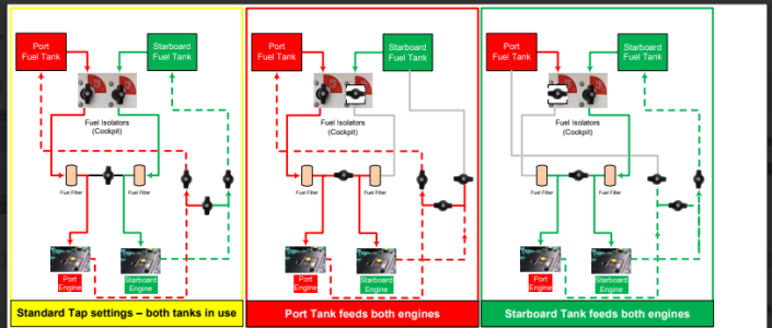

One fuel tank full the other virtually empty.
Are tanks totally independant or is a balance or transfer pipe in there somewhere complete with isolation valve ?
On the F37 you can select which tank is used for each engine using a panel which has nice clear diagrams. I would imagine the F44 has something similar.
