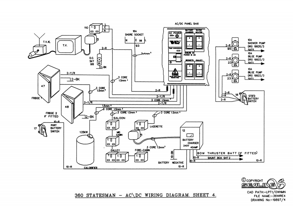

The manual shows a 10A breaker for "Shower Pump" (upper right corner of diagram).
Check this hasn't popped out - they are usually located near the main battery switches.

Thanks for the schematic, will kick myself if that breaker has popped, there are a few under the step with the battery isolators, will also clean up the cable ends
Cheers
