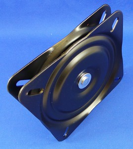

In answer to your original question, can't you just use a swivel plate between the existing pedestal and the seat?
Thanks Nick. Originally I didn't think the current set-up would allow for that, plus I wanted to lower the seat as I'm quite tall. The seat is like a mini bench made up within a stainless steel frame. A picture would offer a better idea. But I've had a another look and actually I think it might be possible. I was transfixed on changing the whole lot by adding a pedestal pole but if I removed the seat and the supporting framework, then I would be just left with the storage box. Whether the box is strong enough in its own right is another question but I imagine it is and it's mounted with four large floor bolts. Also the height isn't quite as bad as I thought, I've even found myself stretching up a little to see forward clearly. So thanks for the simple idea - it might just work :) And the extra storage is proving quite useful.
