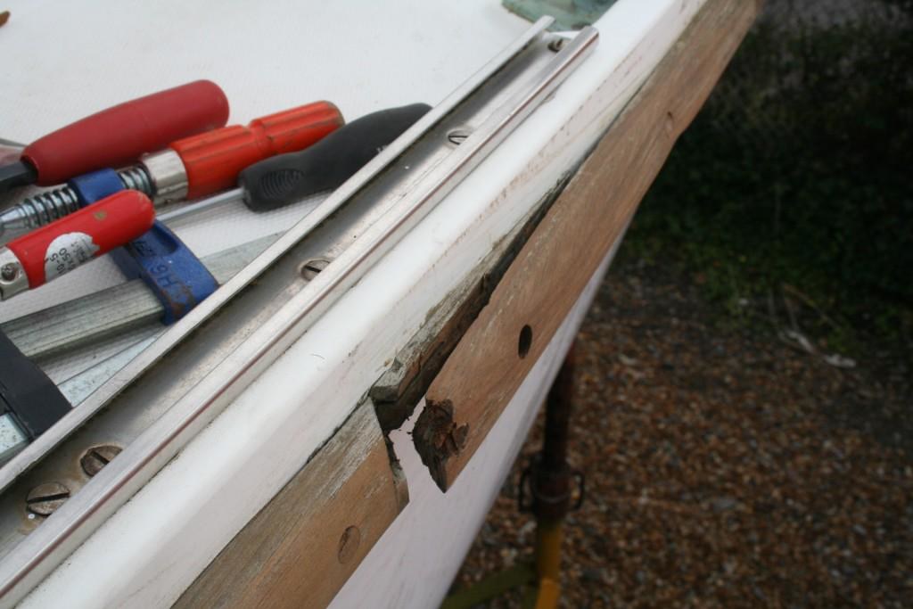

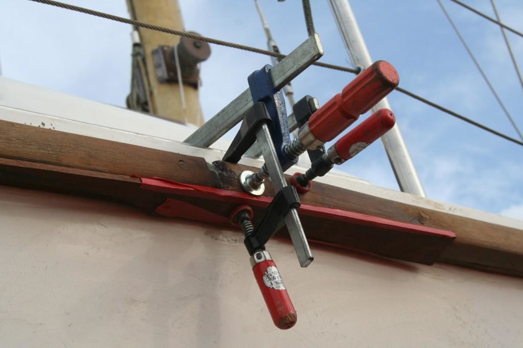

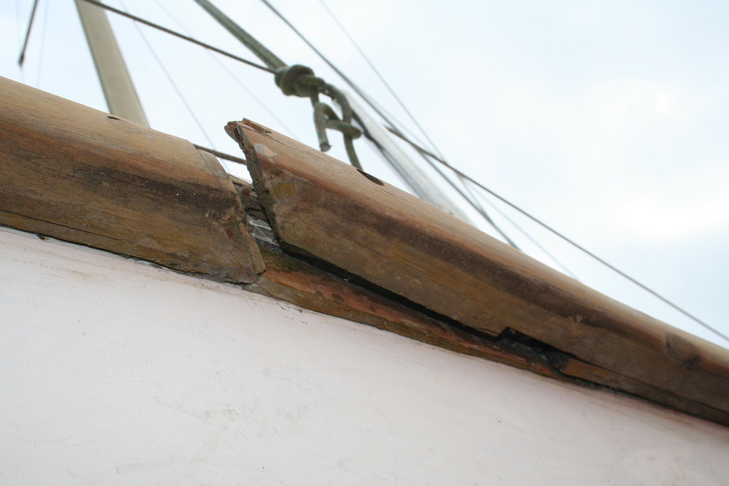

Scarfing a rubbing strake ?
You are going to want to spile this to the sheer to do anything like a decent job (you don't want it bending up and down as well as sideways).
I don't buy the argument on UV failure of epoxy in this instance as all that is exposed is the edge of the glue line. Epoxy as a coating suffers UV failure even in Scotland! Having said that, Maltese sun may reach parts that no other sun reaches.
When I replaced the rubbing strip on Follia Pura the vertical part (from memory) was 55 x 20. It was Iroko and did not require any spiling or steaming, just a lot of clamps.
As for "the Maltese sun" it is not just the UV that plays havoc with epoxy joints but also the temperature - close to 38o in summer - tends to soften epoxied joints. I have never had this problem with resorcinol, neither with Cascophen (which I used in the past) nor with Bindan-Cin, which I use at present; perhaps the heating effects of the Scottish sun are slightly different. ;)
p.s. The boat is a Kim Holman design, meaning that there is quite a curve in the vertical plane of the sheer.
Mine needed spiling for what I thought was a very modest sheer, but then it's section is quite beefy. Putting the scarph a bit skew-wiff dramatically reduced the width of plank required. In truth the decision that it had to be spiled was taken by the professional wooden boat builders who did the work. It may be that they just thought it was the "right" way to do it. It may also be more important in a wooden boat not to apply the bending stress to the plank it is attached to. I wouldn't like to.

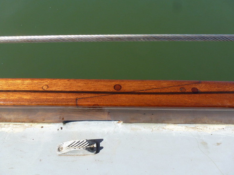

That's a very interesting issue. I wonder if the need to spile is because of the combination of the sheer and shape and length.

Use the wedge shaped bits you cut off as packing for the clamping so that you are squeezing at right angles to the glue line. I actually stuck them to the wood with hot melt glue as I knew I'd be cleaning up and planing afterward anyway.
A very clever idea.
I wish i had heard of that before several jobs I have done when clamping tended to slide the parts down the scarf
