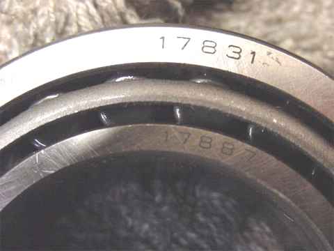

I have a 2002 SBS FK1800 trailer. I need some bearings for it but can't figure out the SBS site. Can someone identify the Al-Ko axle and hub type so I can source the bearings? I think you should be able to double click the photo for the detail.

Take off the hub. You should be able to see the bearing number on the edge of the track. If in doubt, knock them out and go to a bearing factor, who will match them for you. Every city has one.
Better if you can identify them yourself and buy on t'internet. Cheaper. It's pretty pointless buying quality bearings if you are dunking your trailer.
The track and the inner will have different numbers
In this instance you want a 17831/17887.
Some bearing factors will sell bearings which are the same but with different numbers. They will have a conversion chart.

Thanks for that. I was hoping to be able to identify the bearings from either someone's previous experience or an Al-Ko axle number. The trailer is some way away and I want to put a spares kit together so I am prepared.

Simply bearings are a good supplier.I just measure inner and outer diameters and thickness with my electronic verniers.
Simply bearings offer the choice of different bearings from the main brands through to unbranded.
