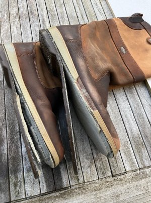

My Dubarry Ultima boots, which seemed fine when I put them on, suffered rapid and catastrophic failure on their first outing this season. While I've had the boots for some years, they're little worn and I alway took good care of them, rinsing them off after every salt water exposure.
I'm fairly certain they are unrepairable though I'm waiting for the word from Dubarry. I know boots have been discussed here several times, but are there any new entries to the market that I should be aware of? At €360 for replacements, a cheaper though less stylish alternative might be worth considering.

I sympathise with you, the quality of Dubarry boots has declined dramatically over the last 10 or so years, it looks as if you have the later inferior welded sole type rather than the superior stitched sole boots, my first Dubarry were great, they were comfortable, hard wearing and superb quality, but eventually started to demise after about 15 years of use, SWMBO bought me a new pair for Christmas, I would never complain to her about them but they are not as comfortable, and certainly not as good quality as my old stitched sole ones which were made in Ireland not Portugal.
Still quietly looking for an alternative make, but so far haven't really found a good alternative, but would be very interested to see what alternatives others suggest.

The only DuBarry footwear I've had were shoes with a similar soles to the photos. They went hard and slippery within a month of purchase and were returned. I have no problem with cheap rubber sailing boots. They seem to last many years and are comfortable so long as you shop around for the ones that fit you.

I have the previous set of dubarry and the heel has started literally to crumble away . I don’t really wear sailing boots but dubarry would not be on my list again . Interesting repairs possible though

i fix anglers waders, wading boots, scuba suits and the like, and if it was not for the missing foam its actually an easy repair. With the missing inner sole its really only a manufacturer repair, or something a really good local cobler could do, if you can find one. If you pm me i can talk you through how to do it yourself, but as you note, with the missing foam its never going to be perfect. If it was not for this it would be invisible! With the inner sole intact, the foam layer, its a £20 repair, but with this now breaking down the problem is getting suitable material to make it right. I would look for someone local who repairs shoes and boots

Dubarry got back to me and determined the boots were 17 years old! They also said the midsole material now is different and not prone to crumbling........
