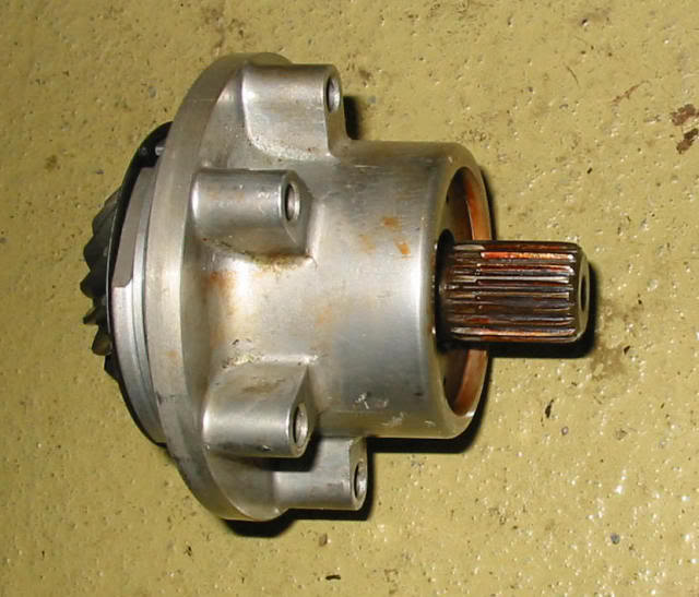

What part of the drive shaft is worn?
He's not referring to the splines is he?
A friend of mine had a boat a LONG time ago that stripped the splines and I'm sure that there was a company that squared off the splined part. Sorry if this is a red herring but it was a long time ago.
If it is I'll contact him and get more details

I amaze myself sometimes ??. Possibly not the issue .... older engine?
Oops ... you already have a damper plate ... might be worth talking to them as if they're clever enough to fix the splines probl they might have a fix for your actual problem that doesn't involve replacement. And they're open.

Yes it’s the splines that the damper plate sits on. Both splines and damper plate have worn right down. It might be a case of putting the saildrive back in getting the boat back in the water and sorting it out without having to rush it. Thanks ??

I had mine re-engineered by DB Marine. Don't ignore wear on the splines. They apparently give way without any warning at all. The photo shows the spline wear and the part that you need to send off. I can't find the photo of the modified unit at the moment.
There are photos in the link I posted in # 11
