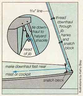

Set ups I have seen as in figure below would involve stanchion mounted sheaves to take the downhaul aft to the side cockpit coaming probably
Not quite sure how the endless system would work in my case.

One issue with a continuous rope would be size ? Halyard needs to be fairly strong so thicker, downhaul has little strain and benefit from being as thin as possible.
Didn't the downhaul sometimes get threaded through the metal hanks?
I found that the downhaul would occasionally try to jam itself in the hanks when raising the sail.
Because of the relative ease of lowering the sail, the idea of running the downhaul(s) along the rail/stanchion seems a good solution to his foredeck concern..
Yes you are quite right. I found a diagram of this set up which I attached and posted earlier
