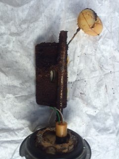

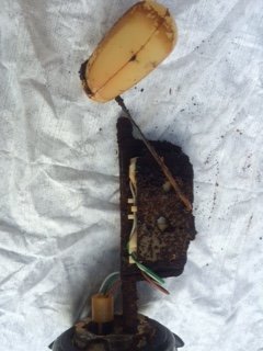

These pictures show a car petrol tank fuel sender after it had stood for 25 years. Replacements are no longer available and I thought it too delicate to use acid. I used paraffin and WD40 with tooth brushes, wet &dry and fine, non-ferrous wire brushes. Patience is definitely a virtue with such a project.
