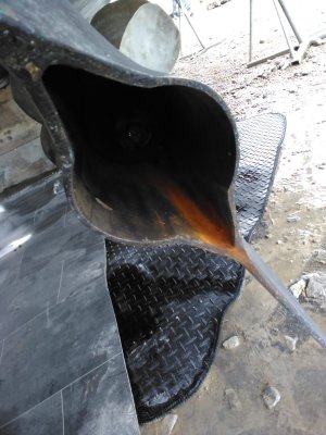

I have an orange powder at the rear of my IPS pod, it looks like rust, but it's not rough or gritty, it's very powdery, any ideas please?
Also, I'm about to peller clean these pods. Do we use peller clean or antifoul in the rear here?
It’ll be the anode, they’re made of iron and will rust.
