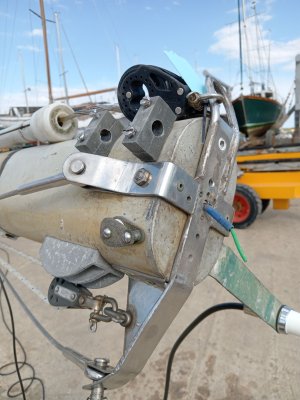

As you can hopefully see, there is only a tiny bit of fragile/rusty flex sticking out at the top through a very small hole. The top of the mast is also covered by a welded-on piece of stainless steel to which the stays are attached..
I think it's possible to pull out the integrated halyard blocks which would help, however, the 55yr old screws on that are currently unturnable.
Hence my looking for alternative plan for this season! But very happy to hear all thoughts!

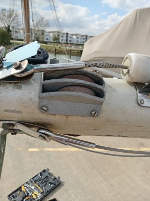

I would be more worried about changing that forestay than running wires down masts
Find out why it got damaged in the first place
I wondered about that - I'll send a pic to the guy who rigged it... I did have a bad jam last year when the top of the jib halyard got twisted around the stay... Do you think it's done for?
That's the classic damage from a halliard wrap. It's essential that the halliard pulls at an angle from the forestay, often achieved by fitting a halliard diverter to the mast. It means that the halliard, after coming off the masthead sheave, is then pulled away from its direct line of pull to the head of the foresail. Yes, that forestay is knackered.
Thanks... Good thing I posted the pic!
Next question - how do I get a new one and can I replace it myself??

No. You get to see a rigger, because he has to swage both ends of the wire through the foil. From your post it does not sound if you have the experience to do your own swages & I would not recommend it anyway
The length has to be exact & the fittings have to be secure, The furling drum & the top swivel may need maintenance & a rigger could sort that for you all in one go
The rigger would probably sort your wiring for you as well.

Poignard
23 Jul 2005
54,262
South London
The tang to which the backstay is attached looks as if it might have a crack.
It may just be a dirty mark but worth checking.
My Twister had an identical mast to yours and the tang to which the forestay attaches had crack half way across. Fortunately it was spotted in time.
