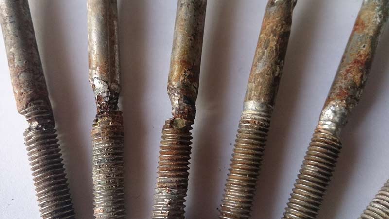

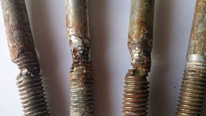

preparing the lazarete for painting after many hours of paint stripping I had a go at removing the M8 countersunk SS bolts holding the bronze (I assume) lower rudder stock assembly.
Port side was fine, stbrd not so fine :rolleyes:
I'd notice some water seeping in from the hull/rudder stock joint on stbrd side when she was launched 3yrs ago and this explains...

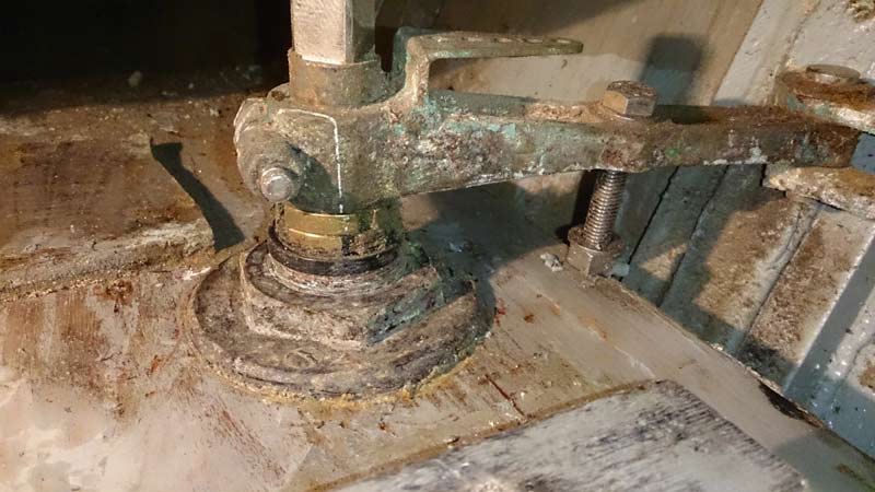

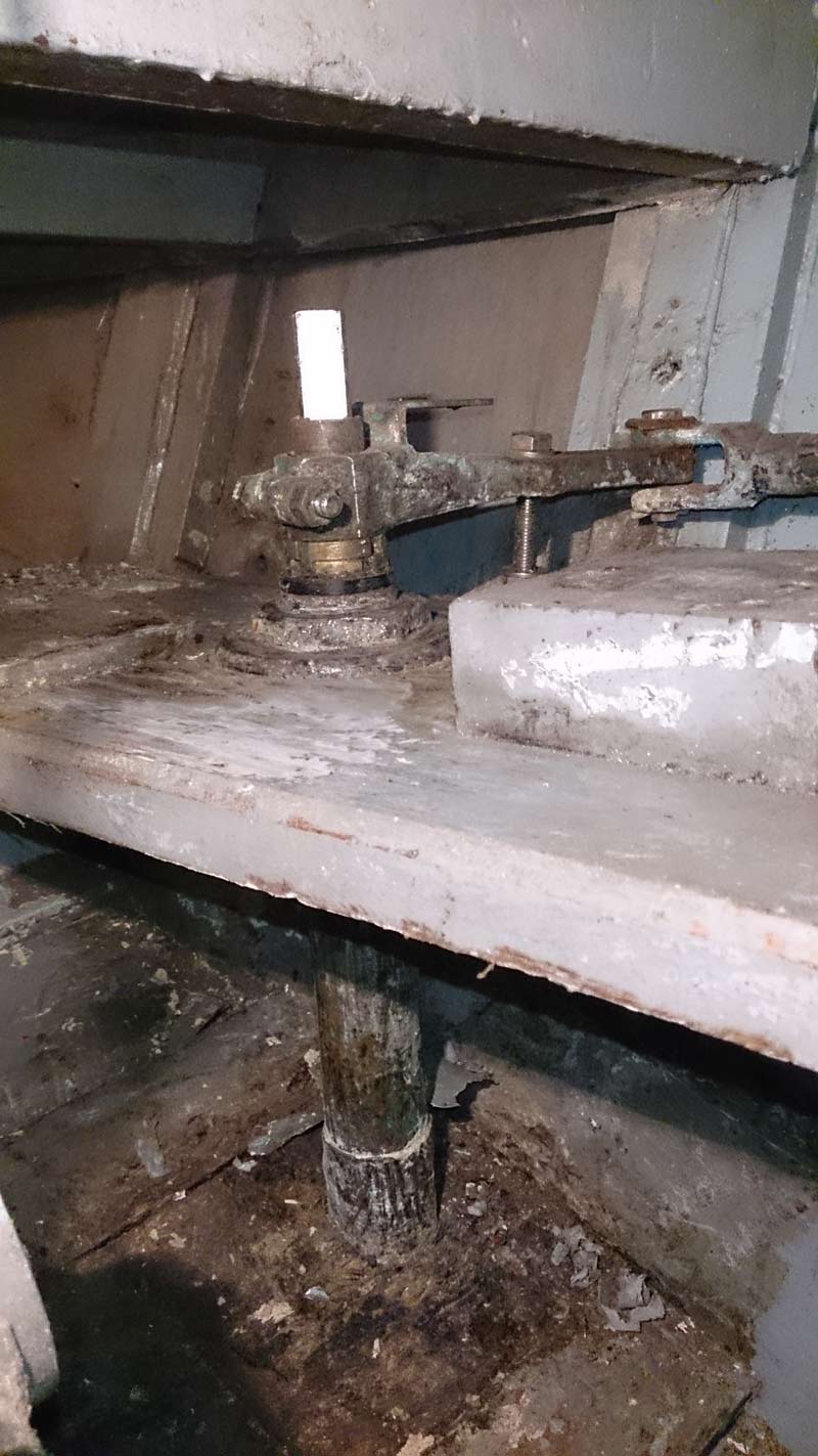

Since I'm at this level, any point in removing the rudders altogether? After almost 40yrs (assuming seals haven't been changed ever) should I undo the big nut and pull (or most likely drop) the rudders down for inspection?
The assembly (ok, not very clean at the moment, just scrapped lots of paint all over, haven't sanded or wirebrushed it yet) looks like this:
Yes, I know since I'm at this stage, I might as well, but I don't know if they have bearings/seals or what. Seems that the top of the assembly is above w/l (may be wrong on that) so I wonder where and how they seal.

HOW do I seal the countersunk bolt/rudder stock joint?
A blob of sika 291 (or 292) or two are good enough?
Any other way? Looked like they'd used some sort of matting similar to what plumbers used in the pre-Teflon era.

Still and ideas on sealing through bolts would be appreciated
Cheers
V
We used sikaflex on our anode bolts. Not to sure re the stainless bolts though, anode bolts are usually mild steel galvanized., and if they were s/s how come they rusted up like that? AHA just reread the post maybe 40 years answers my query. Sorry
