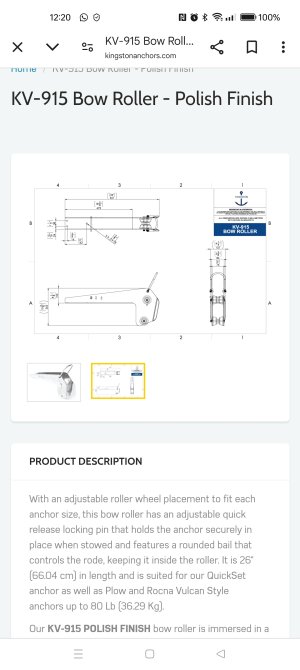

Thanks for help all. I'm going to get a fabricator friend to make one now as I've found him a set of plans .... . Unfortunately you can't buy these in UK
If that is the style you are after, plenty similar available in the UK from makers such as Vetus, Lewmar, Ultra and most chandlers. No need to get one custom made which will cost far more than an off the shelf one

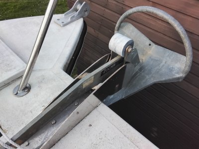

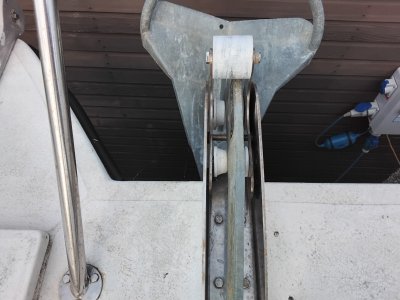

My bowroller. Tilting type and off the shelf, possibly from Force 4 chandlery. I had to modify the top roller by purchasing some nylon bar and drilling a hole through the middle. Grips the anchor quite well but I still tie it down. The two bottm rollers are grooved to hold rope or chain centrally.
