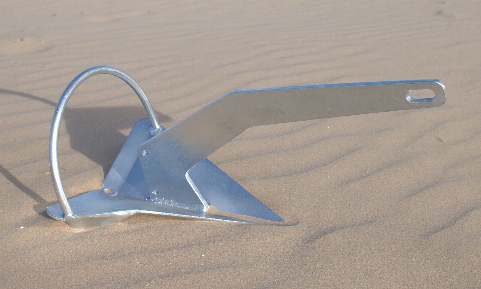

Looking at anchors-these copies look to be dodgy to say the least. Claims to be one piece construction when you can see it is welded together (not too well by the picture), no metal spec and the test report of a boat pulling the anchor in astern and using the logic that this equates to full power ahead seems a bit doubtful also.
The roll bar looks to be much smaller diameter tubing than a genuine Rocna.
I don't know whether that makes any difference .... the quality of the steel is presumably more important.
Richard
On a genuine Rocna the roll bar is a tube, presumably with the intention of increasing tip loading by reducing weight at the back end as much as possible. Also on the genuine article the tube extends downwards to the bottom of the two skegs, where it can be attached by fillet welds rather than the disgusting butt welds shown in the photo.
As you say, it seems unlikely that the material of the copy matches that of the original. Incidentally, the same is true of the Delta copies that are appearing, some of which have even worse welds than those shown here.
So your thinking is that the fake Rocna is using a solid bar of round steel rather than a hollow tube? I had assumed that the fake was simply using smaller diameter tubing but you could well be right.
