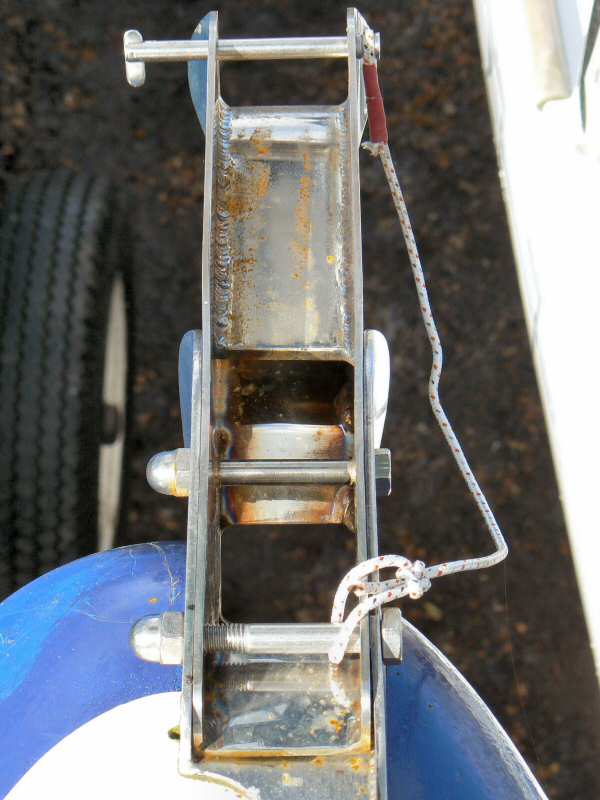

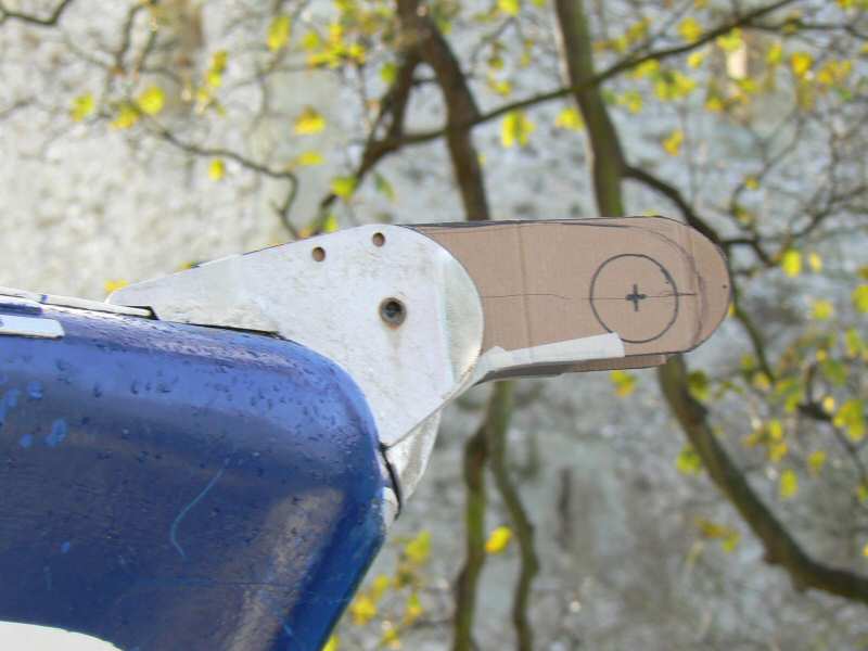

We had a similar problem with the anchor taking a nibble at the stem when lifting and stowed on the roller. Another solution is, as shown below, to get your local stainless man to knock up an extension.
The cardboard one wasn't strong enough :D
