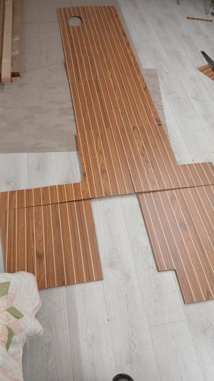

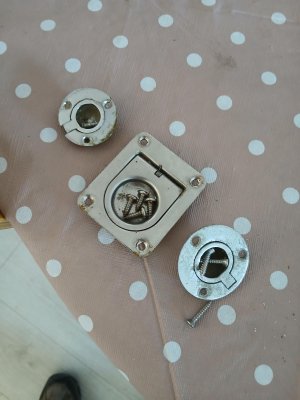

I still have to fit these catches and am a bit concerned about the laminate splitting when I try to cut the holes. Any suggestions on the best approach? catches.jpg
