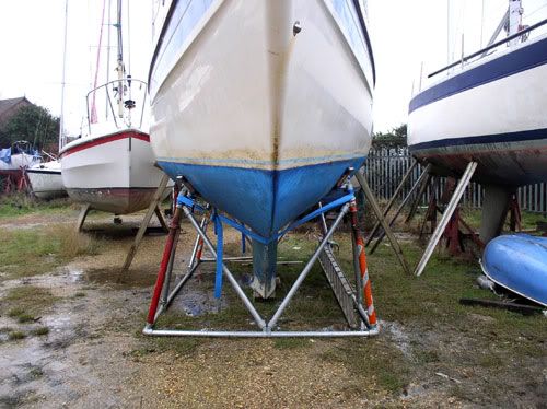

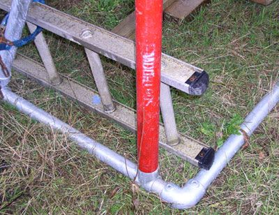

I made a cradle from scaffold poles, acros and the fittings used to make park rails/handholds. Albeit mine is for a 28ft fin & skeg job, but in theory the props aren't supposed to carry any weight are they? In your case, I'd probably suggest three props each side rather than the two I used.
http://i780.photobucket.com/albums/yy87/rob2hook/Mojo - my Weston 8500/cradle3-1.jpg
http://i780.photobucket.com/albums/yy87/rob2hook/Mojo - my Weston 8500/cradlemojo-1.jpg
I also had a local packaging company knock up some full strength ratchet straps to brace the legs and cradle the hull.
Rob.
Great cradle! Where did you get the fittings and acrows from? Did you have to cut the plates off the top and bottom of the across?
All the fittings are available from Plumbcentre and the acros and tubes from any scaffolding supplier. The acros are indeed cut down both ends and then they mate with a stub of scaffolding pole at the bottom and the upper (thinner) end takes standard scaffold fittings. Of course, if you can get second hand bits from a friendly builder, the price drops tremendously. Poles can be cut with care with a 9" angle grinder - wellie boots will make the blade bounce off should you slip, but it still inflicts a nasty bruise!
Rob.
