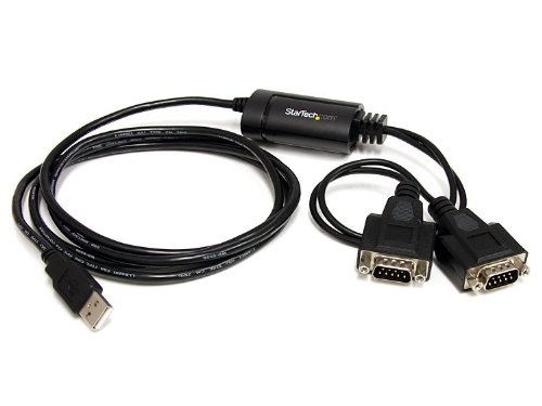

To clarify, the wires in question are not from a standard NMEA cable; they are much thinner. They are the wires that used to go to a DE-9 connector on a dual RS-232 to USB converter, and I have three of them. Like this: http://amzn.to/1ccP1fG
Inside the box in the cable is a PCB with this connector, which is 1mm pitch, so about an inch long:
I've removed all but six of the wires: TxD, RxD, and GND for the two RS-232 ports. One option is to solder larger wires onto short tails, but I'm looking for other options first.
