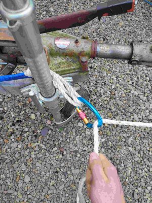

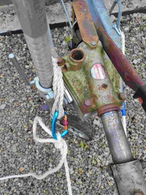

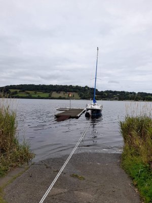

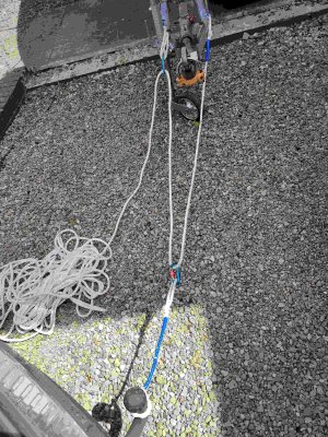

No worries.
The combined weight for mine is about 1200kg and a 2:1 purchase makes this more than manageable, i would certainly use it for something a bit heavier.
You could use a block or recovery ring instead of the carabiner.
The launch process is;
1. reverse the trailer to the top of the slip
2. hook up the rope as per above, but tied off
3. unhitch, the trailer will roll back a foot or so but gathers very little moment
4. with one hand on the rope and the other on the trailer, slowly guide it down into the water
5. release the boat and secure to jetty etc
6. tie off the rope as shown in photo, drive car forwards so that the trailer is out of the water
7. use bricks to chock the trailer wheels
8. hitch trailer back up
The recovery process is basically the reverse of the above.
I have an electronic handbrake and trust this 100% as they have powerful servo motors and fine threads which crunch the pads, i've never had a cable handbrake I would trust the same way so would be inclined to chock the car wheels also if so.

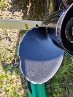

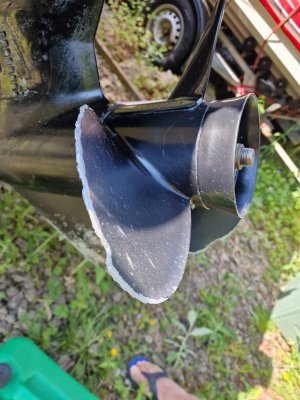

That feeling I had when the boat hit the ground - was actually the prop hitting something, so apart from a little backhander to the first tractor driver and 2 bottles of wine for the assistance on the beach, I know need to think about buying a new propeller!!
I've attached some pics of the blades. None of them are bent, but they are clearly chipped. My question is, do I NEED to replace it?? I know I should for optimum performance etc, but I'm skint and could do with a few weeks to save up! What do you guys think??

Can't upload the other pics, file size ia too large, but all 3 blades are identical with a small bite out of each blade and general putting along the edge of each blade.
