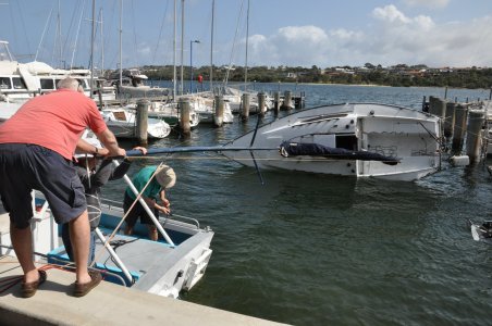

My little boat 21ft was subject to a pull down test to confirm self righting (for racing rules compliance) The boat was tied fore and aft to jetties and then the mast was pulled via a halyard down until the mast was horizontal. A load cell was used to measure force needed to hold mast down. (around 30kg) Now thinking about it we have the ballasted keel and ballast (200kg) sticking out sideways. Being held up out of the water by the leverage of mast to compression post pulling on shroud. A mathematician could calculate forces. In reality no concern. Yours should be the same. ol'will
