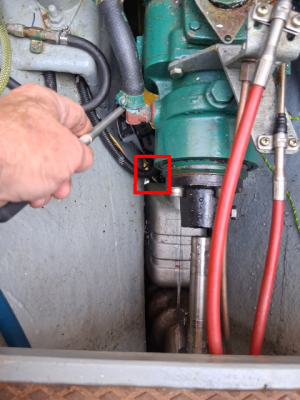

The other day I noticed that the prop shaft had disengaged from the gearbox. Should be a straightforward fix (I thought) but (of course) the stainless steel key had dropped deep into the bilge, just visible but out of reach. I have a telescopic magnetic retrieval tool but (of course) the key is non-magnetic. And (of course) it's wet and oily. The photo shows its position (in the red box). It's right down in the bottom of the bilge below the exhaust.
I can think of various possible solutions but would appreciate any suggestions, including whether there exists a tool to grab this in such a tight space.

Is it just the angle of the 'photo, or is the shaft out of alignment with the coupling and maybe that caused the key to work loose?
I wonder if it is fitted to a flexible drive? Even if it is, every effort should be made to get the alignment as accurate as possible.
It's all rigid and well aligned. I did have it apart last year so probably didn't tighten the locking bolt well enough. The key fell out once the prop shaft parted from the gearbox.
