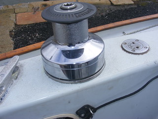

Last winter I went up a winch size and did not fancy drilling new holes, so I made transfer plates:
You can see one under the winch. Basically you bolt the plate to the boat using the original holes and then screw the winch on via tapped holes in the new plates. It means that when I am dead and someone decides to fit self tailing winches they will bless me, maybe.
