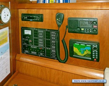

The attached photo shows a new panel made for a smaller 5" Standard Horizon plotter and a larger VHF after taking out a larger (and dead) Raymarine C-series and a working but disliked Simrad RD68 radio. As I was putting a new larger plotter at the helm the little 5" SH made a good repeater. Measured the old panel accurately, and had B&Q make the cuts on their big sliding saw. The new panel was a £10-ish chunk of plywood also from B&Q, picking a nice-grained and clean bit to use. Then made new cutouts for instruments etc and varnished with maybe 5-6 coats of gloss and finally some mixed gloss and matt.
Since than I've replaced the SH plotter shown on the photo with a larger one, again making a new panel as before. Just don't have a photo of the current panel.
