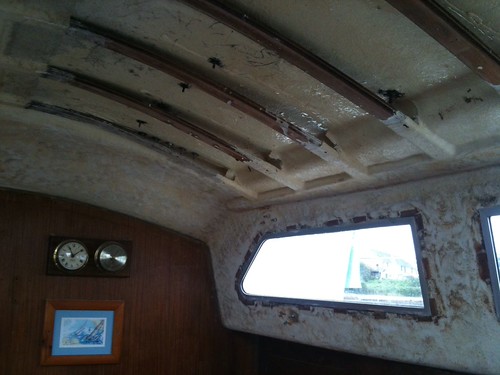

Ok, I think I've just worked out why I was getting quotes of £2k + to replace my vinyl headlining. £300 odd in materials, several missing knuckles and about to spend a third night sleeping in what can best be described as a dusty floating workshop with no curtains, oh, and lots of nice glue smells...and the end is still a long way away! Chuck in fuel to get down, food, and of course beer in the club bar and the professional quote is starting to look not too bad!
Still, what I have done (stbd side/window panel) and the new ceiling panels (yet to be fitted) is looking good. If I can get the port side window area and the forward bit done tomorrow morning I have a chance of finishing it this week. Focsle was done abiut 6 months ago in van lining...but bloody hell, what a nightmare job!

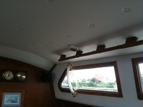

Thanks for the stories and pictures...needed some moral support! But anyway, after 5 solid days of faff, there has been a bit of a transformation...
Excuse the **** picture quality...it looks a lot nicer in the vinyl!:)
