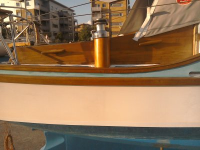

The teak rubbing strake on our newly acquired Seaward has been varnished and is looking very tatty; I intend to remove the old varnish with a combination of scraping and, hopefully, get some assistance from Nitromors or similar. I must confess that I've never had much success using Nitromors on painted surfaces (perhaps I'm too impatient?) and I'm wondering if there's a better alternative.
Any thoughts/experiences gratefully received.

Thanks for the info. - we (dragged my wife into this as well) used the heat gun plus scraper on one side today and it seems to have worked well; now for the other side ..........................
