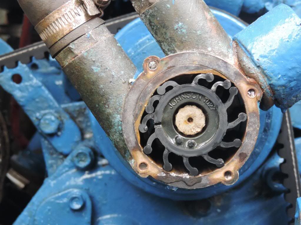

There is one shown in the drawings and instructions for (both ancient and newer versions of) the F5B/9 pump in the Bukh manual and, as Vic has highlighted, there is one sold by ASAP.
Wish my pump was as visible and accessible as the one shown in your pic.
