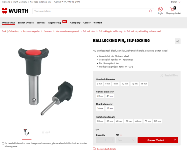

How about a tube style blind insert, 2 or 3 of them, made in A4 stainless, with matching dowel pins on the bottom foot chocks.
If the fit is reasonably tight, then they won't drop out if you have a wipe out and the rest of the time gravity is going to keep them in place.
If you're concerned about water in them, when not in use they could have a silicone bung.
I'm sure I've seen this in a yacht review on youtube, but can't remember which one.
The block just slots in and can be pulled out by hand.
This is the style I mean, I don't know the proper name for them, but they use them for tillerpilots to slot into the cockpit seat.

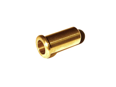

Threaded bushings in the floor, thumbscrews in the footrests?
Threaded two part LFRs in the cockpit floor. They will be almost flush on the deck. Rubber or silicone bung when not in use. Foot rest/brace has rod at each end to drop onto LFR. If you don't like the idea of stainless tube or rod - machine nylon rod with a thread on the underside with a nylon nut. Most LFR makers make 2 part threaded of various sizes, both diameter and length (viz Allan Bros). You might need to brace/reinforce the underside (glassed foam)
