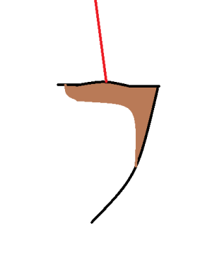

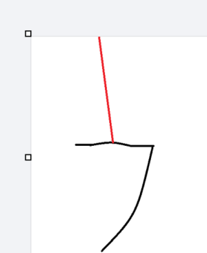

Not super clear from your description of a shelf.
But I'm guessing you have something like this?

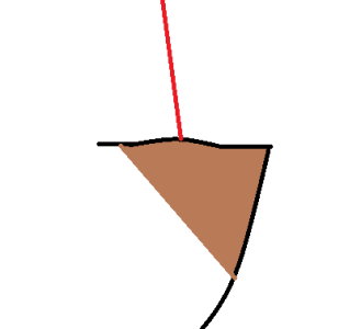

Alternatively, you could glass in a knee or webb to support the deck.
12mm plywood, two layers of 600gsm biaxial on each side of it. (with epoxy). bedded into the hull with thickened epoxy smoothed to make a nice fillet.
And finally 3 layers of tabbing also in 600gsm ought to more than do it.
You could shape it like the 2nd image to make it look nicer.
