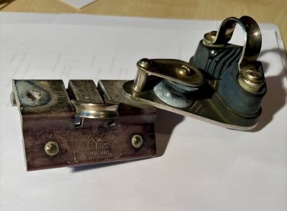

I want to refurbish the traveller on my late 1980's Sadler 26 which has an IYE traveller running on a 23 mm track behind the companionway.
I have learned that it is an IYE Light K traveller and is no longer produced. An uprated alternative is available for eye-watering sums but all I need are the replacement wheels (4-off) and 2 off replacement sheaves for the 2:1 cleat system. I think you can buy a set of 6 replacement wheels and am waiting for confirmation that they will fit my old version.
Has anybody found a suitable solution that does not involve buying a complete new traveller and double cleat/sheave system?
Grateful for any pointers

We make the roller wheels, the sheaves, and offer a full refurbishment service for IYE, Barton, and Lewmar travellers
There are several different sizes of roller wheels on the IYE travellers - what size are your wheel remains?
There are also two different ways of holding them on, the ends of the pins can be swaged over or they can be held on with an E-Clip - we refurbish both types
Getting the central bolt out of the sheave can be a real pain as they are loctited in - apply heat to the bolt head and the traveller body but be careful not to heat the sheaves as they stink when they burn

I repaired one for a club member. I used 'off the shelf' plastic ball bearings locktited into the OE s/s wheels. The origonals were UV'ed to dust. I wondered about the loads, but they are holding up OK.

The way they are designed the wheels are held captive by the load once they are on the track and its not unusual to see ones that dont have the washers and E-Clips
I have had ones sent for refurb that have wheels that have worn down a lot and one where the shafts were separate from the car
I looked at some off-the-shelf all plastic roller bearings as an option for the wheels but given how many normal ones we have sold I dont think they are really needed, I have just done some IYE Track End Sheaves and they have 18 plastic ball bearings on each side of the sheave and were a fun thing to make
