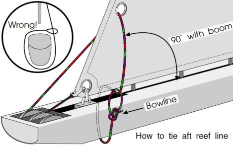

It should go up through the cringle and down the other side. There should be some sort of eye to tie it off to, if not, and it's a loose-footed main, a bowline round the boom is a common way to make it off.
If neither is an option, I'd wander round a marina to see what similar boats do :)
This image shows the lines tied round the boom

thanks - does it just knot around the boom? It’s not a loose-foot main and there is nothing on the boom to tie it too - confused!

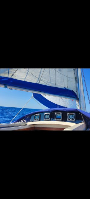

Here is the only photo I can find easily showing my stackpack and a reefing pendant. The blue rope on the left in the pic passes through the stackpack and around the boom exactly as shown in post #6.
New photo · Wednesday, Jul 2 📸
It seems the current forum problems prevent the uploading of photos, so hope this works
