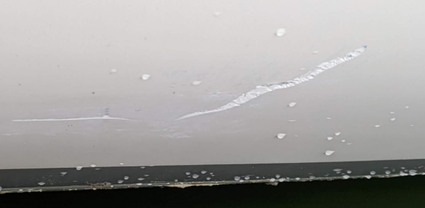

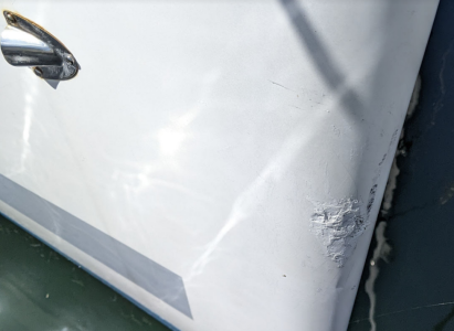

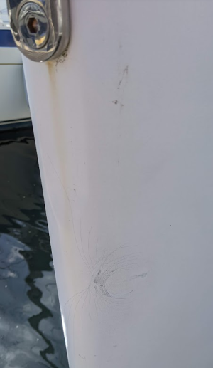

We've been to view a new-ish AWB, we like the boat, but there's significant gel coat damage - she's taken a couple of hard knocks to the stem and there's a ~30cm gouge out of the port side. I'd like to get at least an estimate of the likely cost before making an offer.

[I have a approximate repair cost of £3,000 in my mind. Any thoughts on whether this is wildly inaccurate in either direction ?]
It is difficult to asses from photos as until one grinds off the gelcoat its impossible to know if any GRP below is fractured
Assuming that its not then all are quite easy repairs (I did this for a living by the way) and I'd estimate £1000 for the lot - if there was damage to the substrate then more to grind that out first and repair and then gelcoat over the top

As an update, it emerged that a previous potential buyer had a photo based estimate from a well know Hamble based repairer earlier this year for ~£2,000 + VAT. Obviously more if as @Trident says, what they find in reality is worse.
