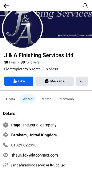

I wonder if J & A Finishing Services Ltd are still just off the M27 at Unit K, Fort Wallington Industrial Estate, Fareham.

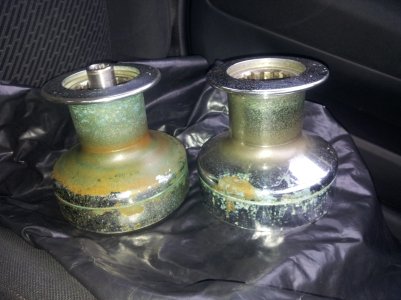

I gave them a couple of winch drums in 2013 that looked like this, with chrome bits the size of finger nails flaking off..

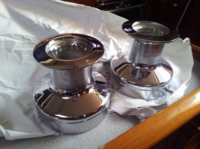

They handed them back looking like this...
Eleven years later, numerous channel crossings and a few Fastnet races later and they're still looking the same.
J & A had a process that de-chromed them first and then the plating process was in a couple of stages.
Their website doesn't appear to work but their Facebook page gives a phone number..

A friend had his drums replated and they came back with the rough texture ground off, which was unfortunate but not critical. The smart ones above are obviously OK, but it may be as well to make sure before handing them over.
