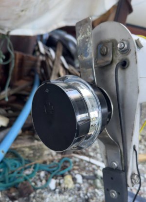

Anyone know the size screws I need to fit to the top of the mast? And the securing bolt size? I can't recall where I put the original or If I took it off the top of the mast so ordered a new bracket. No sizes on the manual...

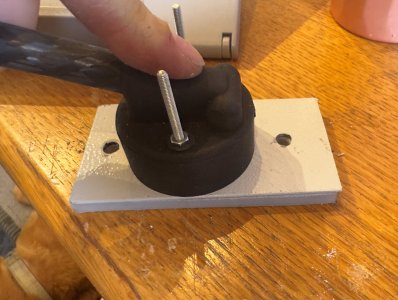

I have the same sensor and no mounting plate...

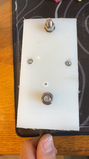

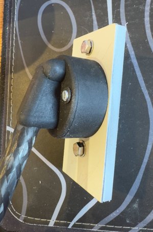

I created a "filler" for the inside of the bottom fitting using plastic sheet, to give something to screw against. Then a larger plastic sheet and a stainless plate to mount / screw the bottom fixing to and to screw that to the mast head fitting.
Worked fine last summer, even in the 50+ knts of storm floris etc..
An easier explanation in photos:

Bottom fitting screws to the plates, plates bolt to the masthead.
