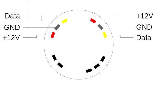

On a lead for ST4000 tillerpilot. Has a 3 pin plug on the end that I will cut off and wire direct to the back of the control unit, but, what goes where ? Thank you

[Image: attachment.php?aid=2858]
Does this help?

Thanks Ian, but do you know the colours onto the Seatalk? I suppose I could buy the jead and socket that goes there, but prefer to scrap the plug.

If you mean cut the plug off of the remote and wire direct to a Seatalk socket:
