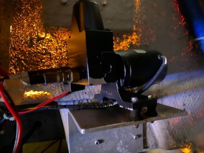

I’d be grateful if anybody could recommend a good engineer around the Solent who could have a look at the hydraulic autopilot on my boat. The controls are Raymarine (ST6000) but the drive doesn’t look like anything Raymarine I can find. I’ve lost hydraulic pressure but the drive unit still seems to function (it makes the usual sound when it’s trying to get the boat back onto a heading) but the wheel turns freely. This is the unit that takes signals from the computer and sends pressure to a hydraulic ram to steer the boat when autopilot is engaged.

MarkView attachment 155428
The pump does not have to be Raymarine, it can be pretty much any hydraulic autopilot pump, it's just a reservable pump.
Does the boat steer from the wheel ?
Check the hydraulic steering fluid.

Thanks - the boat does have wheel steering - rod from a Whitlock column - and that’s fine.
