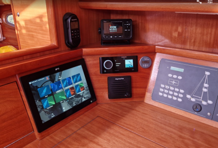

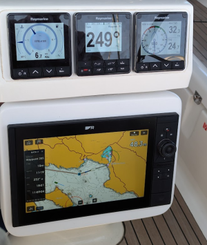

I went all in Raymarine for an instrument system upgrade this year ....
... all functions flawlessly once I had sorted out the multiple sources of GPS info, and got the Yachtsense Link Router connected to the marina WiFi. All the software for everything could be updated over WiFi from the plotter interface. It took a while to iron out some glitches as there was an incompatibility with the VHF wireless speaker, wireless hub, and wireless handset that required an E-Mail to Raymarine to sort out. The response was prompt and I was able to figure out that for some reason the devices I bought had incompatible software versions in them.
Overall very happy and have no performance issues ... will see how it all ages.
View attachment 203378View attachment 203379
