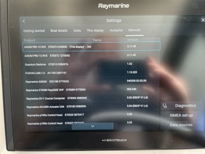

Hi All,
I've recently bought a new to me boat with a Axiom MFD, and a Raymarine P70s autopilot. I had the autopilot engaging correctly 2 weeks ago and steering towards the correct heading, and I have it on good authority from a professional skipper that it was engaging correctly during a delivery trip under previous ownership approximately 7 weeks ago.
The trouble is that during a day trip this weekend, every time I engaged the autopilot I got a 'no drive detected' message followed by alarms on both the MFD and on the Auto pilot followed by a failure to move the drives and change heading. The trouble I now have is that the boat is new to me and this is the first time I've used an autopilot; My understanding from a bit of internet reading is that the Autopilot is joined together into a 12v system with an ACU, seatalk backbone, and a drive unit to move the outdrives?
do any kind soles have some pointers on how to diagnose what may be stopping the AP from talking to the drives and giving this message? I'm optimistic ( hopeful!) that this may just be a power / trip switch / fuse / connection type issue; I'm reasonably handy and have a voltmeter (!!), but would be really grateful if anyone could suggest the sort of places I should be looking and checking first?
thanks in advance
So! It turns out that if you turn on the big button called ‘autopilot’ the AP can see the drives! 🤬 😳thanks for jerbro and Paul for taking the time to reply- I’ve learnt something now!
