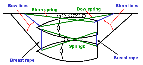

Rafting's great fun. Get stuck in! You need lines at the bow and stern to the boat next door, plus springs running diagonally, and don't forget to run lines ashore or you're putting all the load on someone else's cleats.

So you need your bow and stern lines and springs attached to the boat you have moored against, then you need shore lines, that is lines from your boat to the pontoon (so if your are 4 boats out you must ensure you have long enough lines to reach), fore & aft.

Ok...so it's bow, stern and springs lines to neighbouring boat plus bow and stern shore lines yes??

It does require people on the boat on the outside of you, preferable on both boats & then for example if you are going out forwards. Firstly remove your shorelines. Then boat to the outside of you takes their forward shoreline and removes it from the pontoon, but still attached to their forward cleat runs it behind everything on your boat and secures it to the boat on the inside of you forward cleat. Then they remove their stern line from your boat and run that behind your boat and attach to the insides boat stern cleat.
Then the exciting bit, remove your springs and lines to the boat on the inside while the boat on your outside removes their springs and forward line to you. Then you slip out forward, once you have gone (and left the carnage) you leave the boat to the outside of you to heave in their old forward shoreline which is now attached to the inside boats forward cleat and stern line which is also attached to the inside boats stern cleat... not something to be attempted in high winds or strong tidal situations, or if you do be prepared for a big audience!!

sorry had a good look through the slidesets and only found a none animated diagram... similar to this one.
in hindsight, I think he talked us through it as per firefly's process
Firefly...thankyou. had to read it twice and somewhat slowly :) but yeh, it makes it clear. (am going to write it down verbatum and keep to hand :) )
