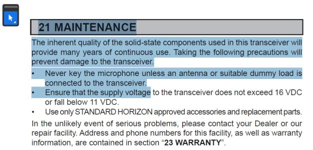

OK .. but Radio Manuals still tell you NOT to do it ...
Here's Standard Horizon as example ... a regularly recc'd VHF Marine radio on these very Forums ...
