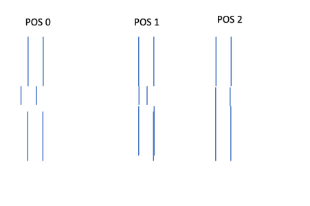

Thanks, but not quite what I need. I need 2 INDEPENDENT circuits. Switch POS 0 both OFF; POS1 Circuit 1 ON, Circuit 2 OFF; POS3 Circuit 1 ON and Circuit 2 ON. See screen shot
